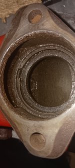

Thanks. Got it out, however it looks like there is a snap ring retainer that was holding it in??? I can see it now that it's cleaned up a little

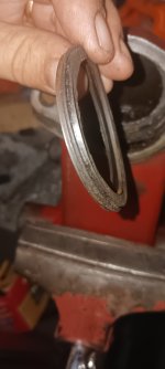

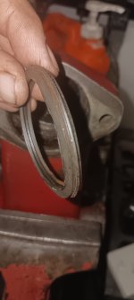

Holy cow. They're making this difficult. The rubber seal is grooved on the OD for the snap ring and grooved on the ID for the thermostat. Not sure how this is all going back together
