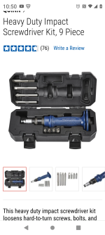

I tried the slotted impact driver and it is not deep enough, and has partially stripped the slot. The long screwdriver, I can't get enough pressure.
I understand now why Johnson outboards went out of business.
They make a driver with longer bits at HF.
