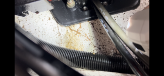

Thanks for the feedback guys. I’ve attached a photo of where the leak was coming from, it is a sort of brown stain on the left side. The mechanic is saying this is an indication of a wet transom. Today I went over there and did a very thorough sounding test on the entire transom, both inside and out. I did not hear any difference from the leaking area to other locations. It sounded bright and crisp with no hollow sounds at all. Shouldn’t I be able to hear the difference if it’s as bad as he’s telling me??

It could be just an assumption, so it needs to be verified before putting money and effort into it.
it might be good to get the boat out of the water and take some core samples of the transom, both near the leak and elsewhere

Your picture doesn't look too bad. Brown water can be rot...or rust.

Sounding test is worthless unless the boat is completely rotted away or you are highly experienced at examining boats. Drilling core samples from inside is a MUCH more reliable way to check for rot.

Yea, that’s my plan for tomorrow. It is dry docked right now so I going to drill a few holes and see what I find
Probably a 1/4" drill from the inside near the leaking area and a few places higher. Go about 1" deep (the transom is 2" thick). Take pictures and save samples of the shavings, noting if the are wet, dark, mushy, etc.

Also, if you have access to an infrared camera, those are effective in identifying wet/rotted areas within a hull. Another thing that you can do is use a fairly inexpensive probe type moisture meter and just drill slightly through the fiberglass coating rather than deeper into the transom, so that the probes can touch the core material.
Also an IR temperature probe may be useful as wet/rotted areas of a hull tend to stay colder than surrounding areas as the morning temperature rises.
the list of possibilities includes a failed transom seal or even a loose mounting bolt, which are much less expensive to fix. So, that is why you want to verify what a mechanic may be telling you. (not sure what amount of diagnosis has been done or if a marine moisture meter was used on the hull/transom).
It is best to know for yourself before proceeding with any amount of repair work.

Hollow definitely = rotten. But definitely rotten does not always = hollow. Most of the time tests like "sounding" or looking for flex while standing on the drive are crude and don't tell the full story. Rot is a cancer, and these tests only detect the very end-stage of the disease. If the glass is thick enough, it will sound solid regardless of what is (or isn't) behind it. I experienced this in my rebuild.

Thanks for the advice everyone. Just wanted to share the rest of this story. After drilling a couple holes I’ve found that it is definitely wet and at the beginning stages of rot but it’s actually not terribly bad yet. I don’t have any stress cracks or the interior glass beginning to delaminate. I had a mechanic pull the engine and crank down the bolts but that only slowed the leak down temporarily. (Another indicator of it getting squishy in there). He says that there are spots he could see the plywood core between the inner and outer transom assembly and it didn’t look bad at all. My plan for the fall is to wire and plumb in a backup bilge pump totally independent from the primary pump. I’m going to pull the drive off and look for any spots water may be seeping through and put some 5200 around the outside transom assembly. It obviously is going to have to be fixed correctly within the next few seasons but I don’t think it’s as bad as I was initially told. I’ve watched a lot of YouTube videos recently about rotten transoms and mine isn’t even close to that. Also, it doesn’t look like too bad of a job, I’ll do some research and be ready to tackle it myself a few seasons from now.
