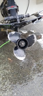

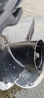

Question 1 is around the propeller, it looks like it's had a hard life but whether it's condition affects how it runs is part of my question. As we use the boat for towing a biscuit/tube, skiing and wakeboarding, is this the correct propeller to use? The writing on it is Solas E3x14.8x7R. I have seen 4 blade and 5 blade propellers before, which is best?

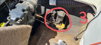

Question 3 is aligned to picture 3, which oil pump is this?

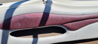

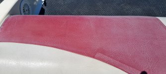

My last question is regarding the vinyl seats. They are badly faded and a shade of brown from dust and dirt and heaven only knows what else. I've tried soap and water with sponges and hard bristled brushes. Has anybody got any advice on what I can try to use to get these back to a semi decent shade of white and red/maroon?

1) If the propeller works well for the water sports and you are hapy with it, then don't fix what ain't broke. If you want to get a bit better take-off for water sports, try a 4 blade with a bit less pitch. You'll have to look up what the pitch is on the current Solas prop.

3) Trim pump.

5) Try some vinyl cleaner/restorer on the seats with both a cloth and then a mild scrub brush to see if you can improve the appearance.

I think you should get a new prop. That one has significant chips, which will cost speed and efficiency.
Make sure the current Tach turns in the middle of the max recommended RPM range before choosing the pitch of the new prop. If so, a 4 blade with 2" less pitch may be better for that relatively heavy boat you have.

1-Need a wot run as loaded with current prop to know if the motor is revving inside its min-max wot rpm parameters factory stated which need to know in order to prop right that combo towars max wot rpm range to pull skiers out of the water faster...

That prop can be repaired for a lot less than replacing it, and what everyone else said.

Gee, you can get a brand new Turning Point 4 blade prop housing for MerCruiser for under $100. I use this prop on my heavy 21 footer and it works well.
Cheaper prop housings are also available. Likely a direct replacement for yours is about $75.
A reusable hub for that prop and many others is about $45.
If it were me, I would run the boat up to max RPM with the current prop and then decide what pitch prop I wanted and order new. Keep the old one for a spare.

With regards to the propeller, besides for opening up a can of worms :D due to my lack of knowledge around propellers and how they perform, I am simply wondering if a propeller with more blades would yield any different results in getting a skier or wakeboarder up. The one that is on the boat at the moment works well enough to get my overweight butt up on a wakeboard with 4 on the boat but due to this one looking like it has been used in a rock pool, I'd like to replace it. If the advise I am being given is that this one is fine, I'd prefer to get the same one new as opposed to having it repaired.

With regards to the vinyl upholstery, a few hours ago somebody asked me why I don't just dye the vinyl - I didn't even know that that was a possibility. Has anybody done this before? I will put a post in the restoration section around this but thought I'd ask anyway. I am considering putting a grey 3M wrap on the hull of the boat so if dyeing the vinyl would work, I'd simply dye the maroon parts grey to match the boat.
