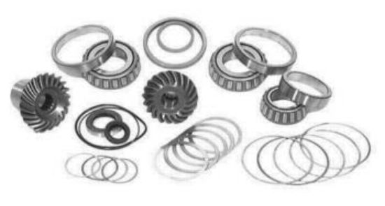

Ok Gents, I talked with local marine wrench here that I trust, ( know him long time ), He quoted me this morning, with the Heavy Duty gears, full rebuild, And reseal of lower, I think it was about 2300 bucks
I know the HD gears are twice the price of Reg. gears
They charge 125$ per hour. He say 4-5 for upper, 3 or so for lower.
Not looking for agruments at all.
Does it sound fair ? I am a fair guy..

Would be cheaper to buy a complete drive
Paintman1960
Apr 21, 2021
159
Scott, From who ? SEI ?
He say they use chino gears,
Did'nt have much to say about them, Esp. with Engine I have
SEI shipped to me is about 1900 bucks
400 dollar diff. and 5 miles away
52,358
SEI is new with a warranty $1855
Used Merc drives in the $1200 range
Rebuild yours $2400

If you go this route, those times (for labour) are about right.
