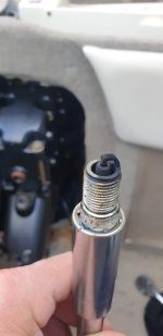

So my thoughts are from other threads that maybe accelerator pump or something else??? i don't know. I only know enough mechanical stuff to get out of trouble. Carby tuning seems like a dark art to me and getting it right takes a lot of experience so I reckon I have messed something up. I pulled the spark plugs to have a look if lean or rich. From other sites, i was expecting a lean looking plug, but i think this is a sign of rich (see attached pic)??

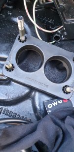

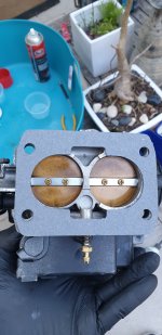

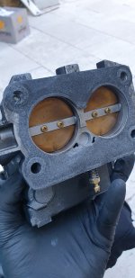

So, i took the carby off and re-cleaned it, with attention paid to the vacuum piston. I couldn't get it out and didn't want to risk breaking it so cleaned it best I could. There was some small amounts of gunk and after putting some silicone spray it seems to move pretty freely. Im putting some paint on carby now and will bolt back in.
One question, the carby seems to sit on a plastic spacer on top of the engine. The gasket i used between the spacer and carby had a centre piece that must have perished and got suckered into the motor at some point. I have only noticed now after taking out that the 2 barrells of the carb aren't separated down the bottom.
1. Will the paper gasket be caught somewhere further, like a valve? Or likely burned up? Hoping the second.
2. Should the 2 barrels be separated somehow at the engine? Am I missing a part?
See pics. 1st pic is of damaged gasket. 2nd is the new one. 3rd is picture of the spacer on the engine.
Thanks

MarcelSydney
Jul 5, 2021
58
Thanks
Sorry the first pic didn't upload..damaged gasket attached

AKJohne
Mar 26, 2017
220
You Aussies got it made with 98 octane. !
Was there crap in the carb when you cleaned it the second time?
Did you blow out or replace the fuel lines?
Gasket probably went through the motor OK, not ideal but doubt its terribly detrimental.
