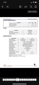

The Venturi is larger, as the carb has a higher Air Flow. A 5.7 needs a bigger Carb than a 5 liter. Rejetting is not going to make it a bigger carb
I didnt mean to rejet- both the 5.0 and 5.7 have the same jetting. this is the file I meant to attach with those specs. Not sure if the venturi is any different other than the holes for accelerator pump nozzles, which could be drilled out.

If you have too much pitch that would be the case, but usually to get on plane relatively quickly I'm 2/3-3/4 open throttle, then pull back once on plane. Your WOT RPM will be key- if you are on the low side of your range say 4400 rpm go down to a 19" pitch.
The carb was set up for a 5.0 - the jetting and power valve is the same as in attached file. The venturi is different as it has larger accelerator pump discharge holes on a 5.7. Not to over complicate things but might help to drill out the accelerator pump discharge holes or move the pump arm lever to the closest hole to get a bigger shot (2nd attachment).
The linkage is in the middle "B" hole.
