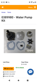

I haven't dropped the lower unit yet but going by parts diagrams there are no gaskets needed for the plate and pump housing? metal to metal for these? can someone confirm if that is accurate?
saltchuckmatt
Jul 19, 2019
2,850
Didn't have your exact model number but I believe this is it. Updated part number with gaskets.
F_R
Jul 7, 2006
28,226
Original aluminum pump, replaced by plastic pump with stainless steel liners. Can't tell which is in there without looking.
