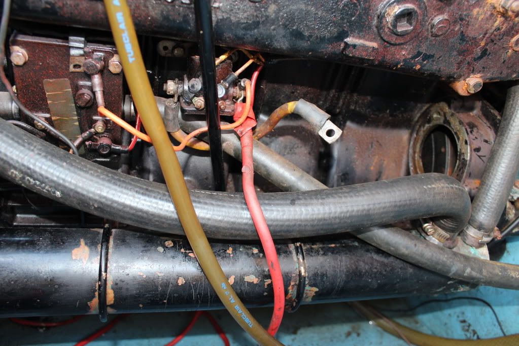

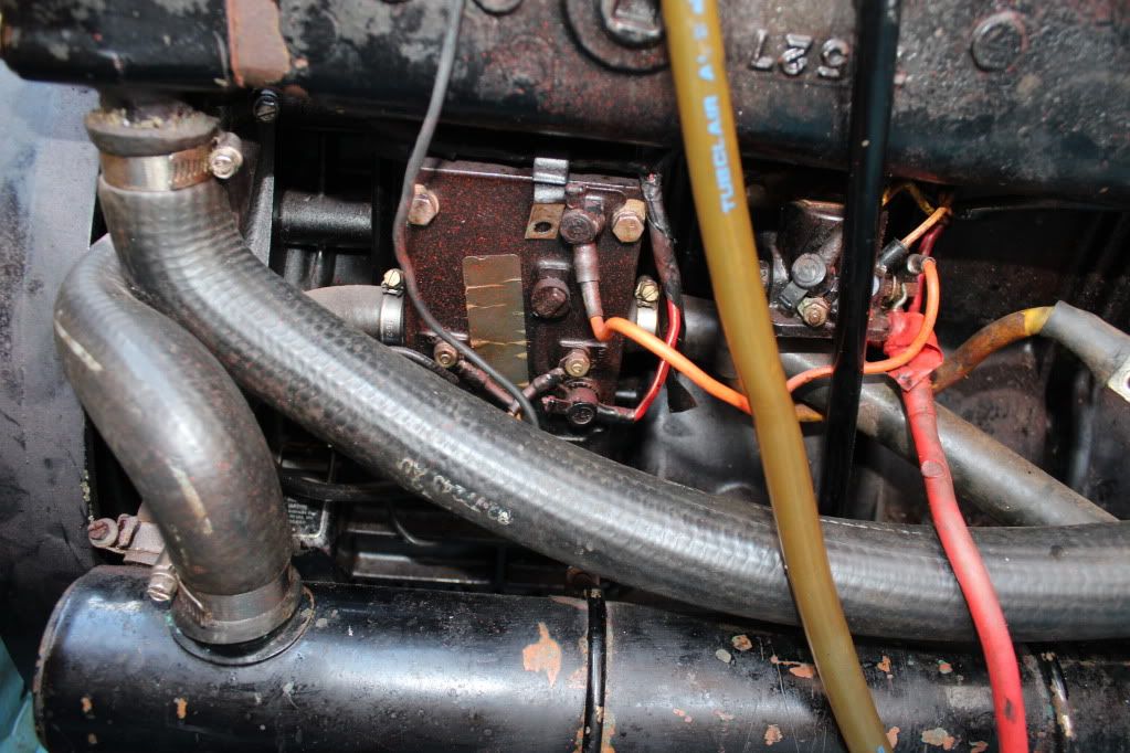

that square thing with wires to it and a hose on the sides of it in your last couple of pictures is the factory water cooled voltage regulator, which is usually what fails and leads owners to go the belt driven alt. It was never removed.
correct me if i'm wrong it still looks like the old voltage regulator is still live. you need to snip the two wires that go to the old stator. in this picture you see what i have done to my old stator wires which lead to the voltage reg. when i rebult my motor i totolly removed the volt reg alltogether i also removed the copper tube from volt reg and used that so the water will still flow. in the picture you see a black, 2 yellow, orange and red wires remove them you don't need them any more

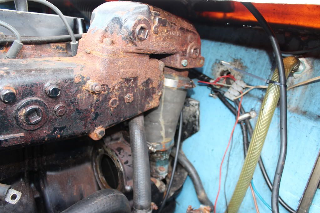

by the looks of your pictures motor doesn't look that bad but keep an eye on your exhaust manifold and riser there is some good corrsion going on there

voltage reg there is three bolts that hold it on just remove them and your good to go. you can see them in your picture but remember you have to replace it with a tube to allow water flow to the heat exchanger. there is many types of tubes you can use this has been dicussed for years. i just knocked the copper tube of the volt reg and it works good for me

just keep an eye on the temp and the level of the antifreeze if the riser is not leaking then don't worry. when you pull the riser off then you might have trouble. the machined surfaces have to be flat with the riser and exhaust manifold they are cast iron so when they corrode that's where they start right on the machined surface so when you try to put the riser back on the gasket can't do it's job when the machined surfaces are corroded. there has been many pictures on people that has had the same problem maybe some of them could post a picture to see what i mean
