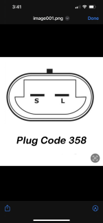

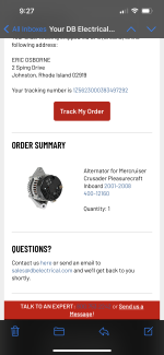

IMG_4623.pngHello this is what i got from DB electric for what pin does what.
52,313
one wire is the ignition reference, one is the idiot lamp.
S = Sense wire. this is purple and comes from your key switch
L = Lamp. this is a ground feed to your lamp (the other side of the lamp goes to the ignition switch.)

Purple from key this is the purple from the engine connector correct? Sorry still have motor out of the boat.
alldodge
Mar 8, 2009
43,905
Yes, purple is purple anywhere from the helm to throughout the motor "unless" someone has bugged things up
