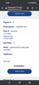

Doing some research on a sea water pump i just noticed something odd. The pic i attached of the impeller shows a PN of 21213650. Yet, i can't find that part anywhere. Everything comes up as 21213660. I got this impeller last fall from a dealer in Alabama and provided the engine serial number.
Was 650 superseded by 660? if not, what does 650 go to? Doesn't come up on Cecil Marine's site either.
