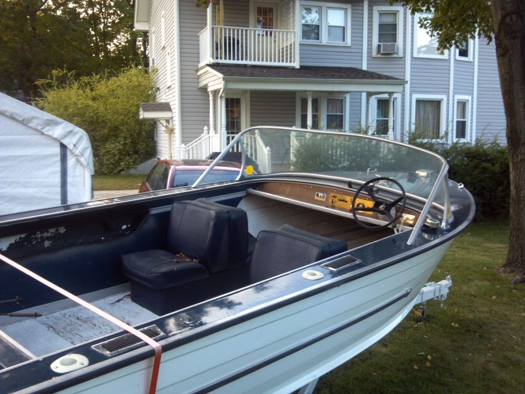

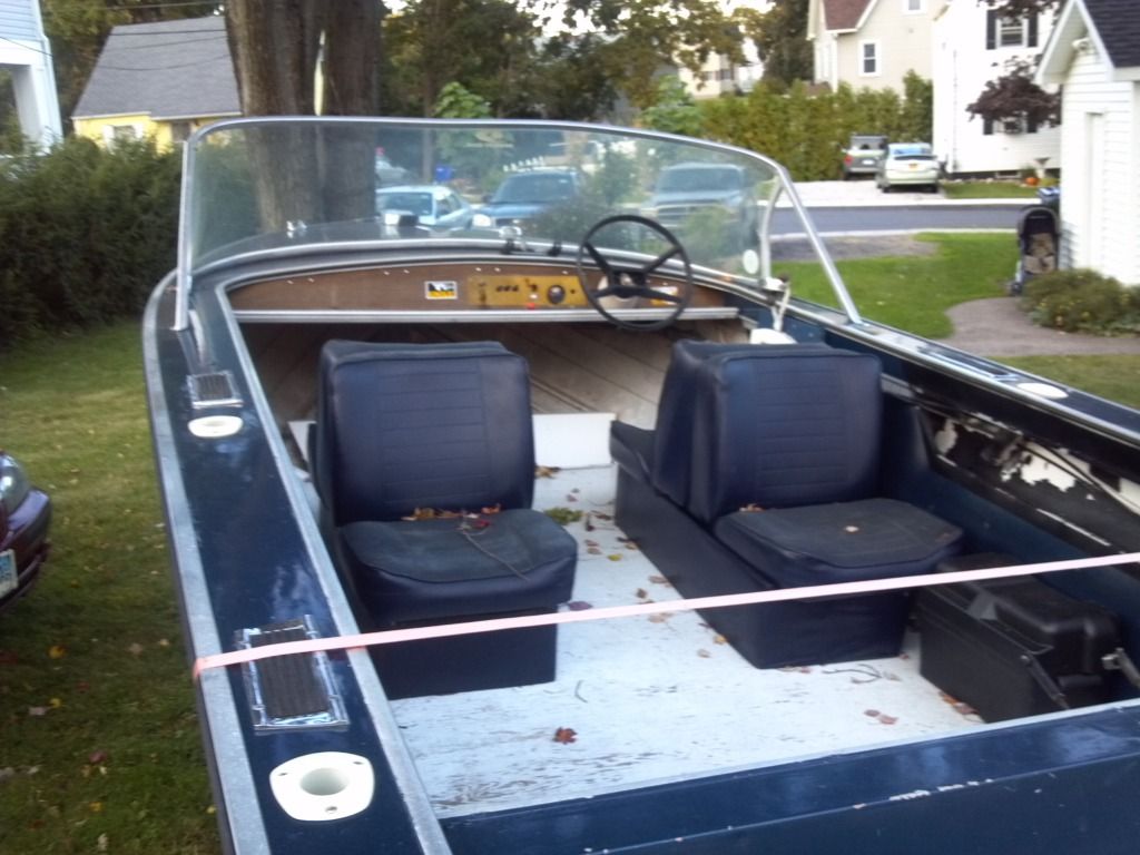

I think I'm getting the hang off this! Not to bad for $400.
Triton II
Nov 23, 2004
2,479
Re: Another Starcraft addict born
Wow, excellent buying TF... now just splash her! :)
