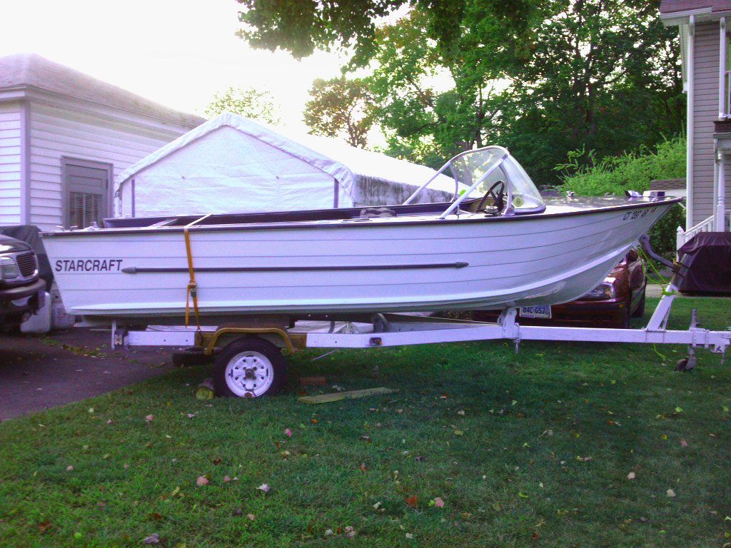

Welcome to the Tin Asylum, tinfever. You got a nice looking Jupiter at a darn good price. Thanks for the pics. We like pretty pictures. :D
What all are you planning on doing to her?

Thanks for all the positive comments! I a honored to be a part of the Tin Fleet. She will receive a FULL restoration in the spring. I have already redone the the transom wood and rear section of the hull has been stripped, primed and painted, just waiting on a decent day to reassemble and mount outboard. Over the winter I will work on trim, interior and rechroming. Will probably stay with the white and navy blue color scheme.

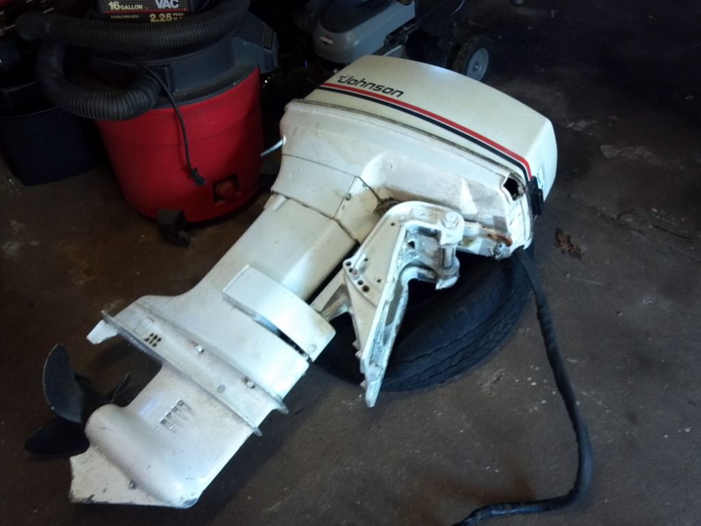

This is the 1983 Johnson 60 that cam
e with the boat, runs great just needs a starter.
