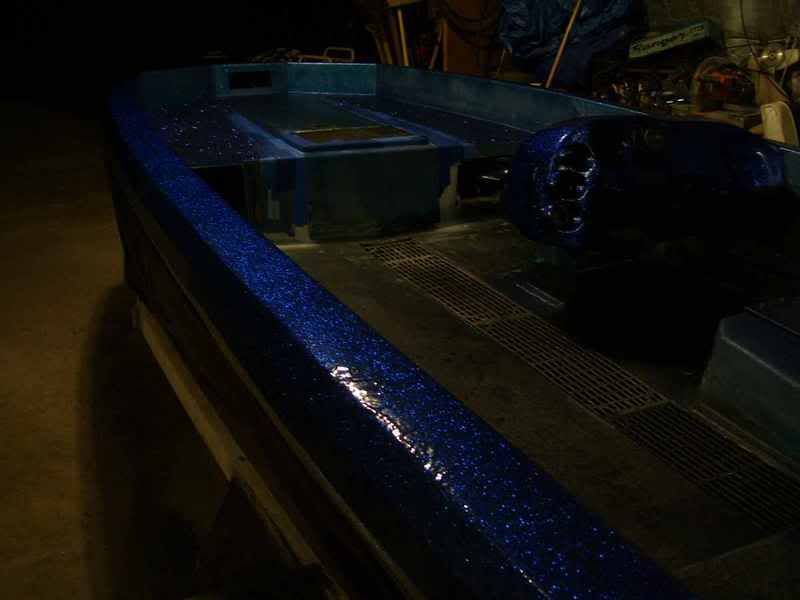

The pic was taken to show where I messed up my recently sprayed metalflake-gelcoat with my shirt.
But in the background, there is a floor grate covering the bilge area. Made of welded plastic sections of HDPE bread crates.
A work in progress

The only problem with your floor grate to the bilge, is if you get a hole in the hull...you'll sink very quick like a rock thrown into the ocean...LOL! If you seal off that grating, you'll create an airlock that will prevent you from sinking....so quickly...LOL!
