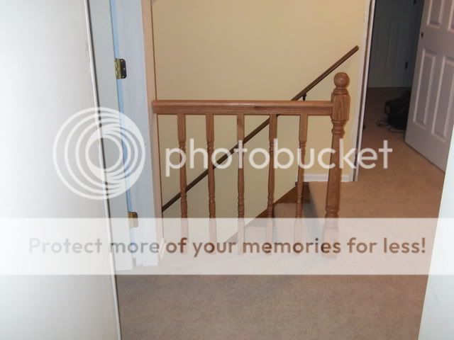

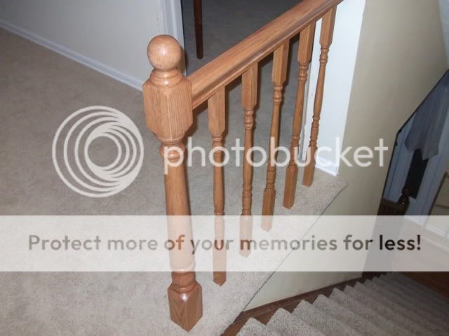

We had our new carpet installed upstairs the other day so I thought I would update this thread. The rehab of our upstairs is nearly complete from the previous owners abuse.
I refreshed the main bath with new toilet, painted vanity (it looks really good) a granite vanity top, and new faucet. The old doors that were scratched up have been replaced with more modern 6 panel doors (I still need to put up the casing). New carpet installed throughout the upstairs, and of course that brings us to the newel post.
I've never done a job like the newel post before but I must say that I think it came out pretty darn good.
For those who don't feel like scrolling up, here is the before...
And here is what it looks like now...
