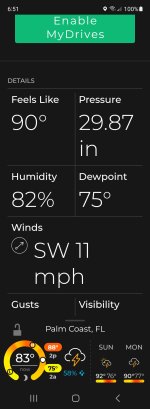

mickyryan
Apr 18, 2016
4,216
Well at least it's cooled off a bit :)
