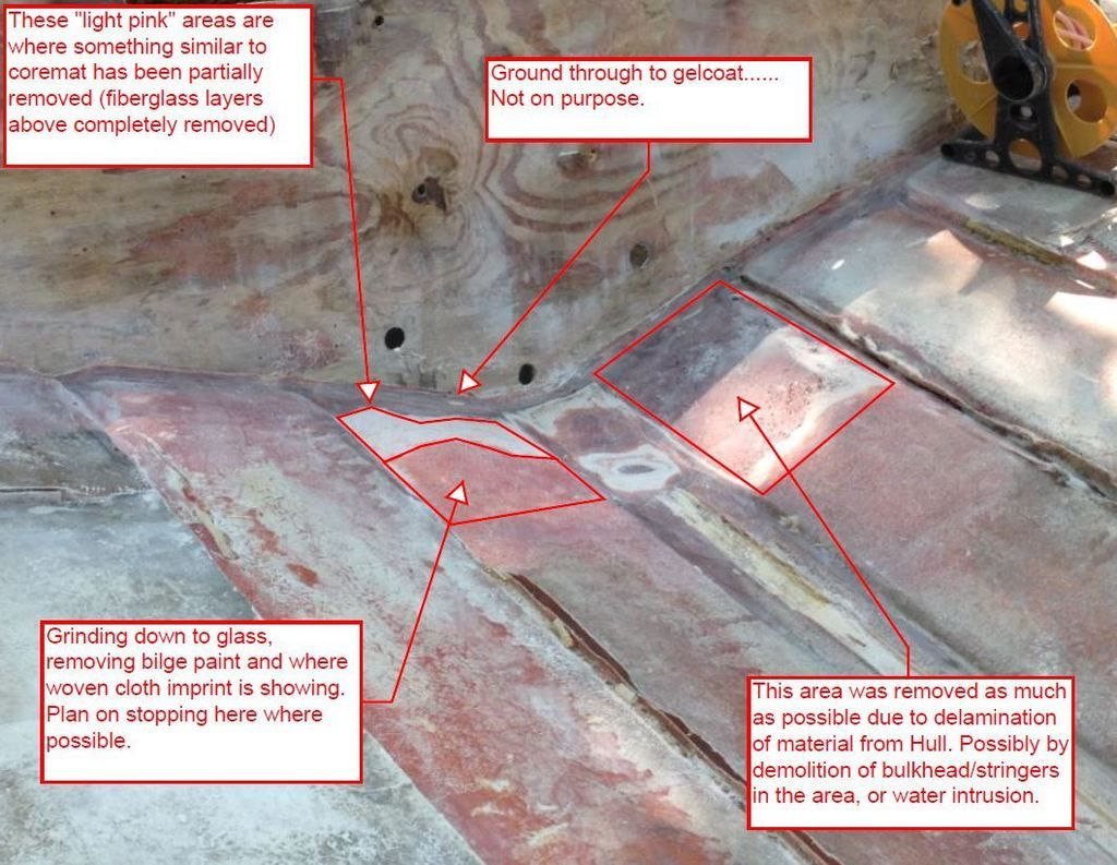

I will not get to grind on the boat this weekend, taking the family on a long weekend beach trip. I have however been researching my situation, because I was unsure on what I was doing. I had some delamination of the hull in the bilge area, so I removed all the material, down to the last layer of glass before the gelcoat. What I understand is I'll have to build this back up after I grind it down some more to get the right pitch, about 12:1. If anyone has any advice, or thinks I'm on the wrong path, I'd appreciate any tips. Thanks and have a great weekend.

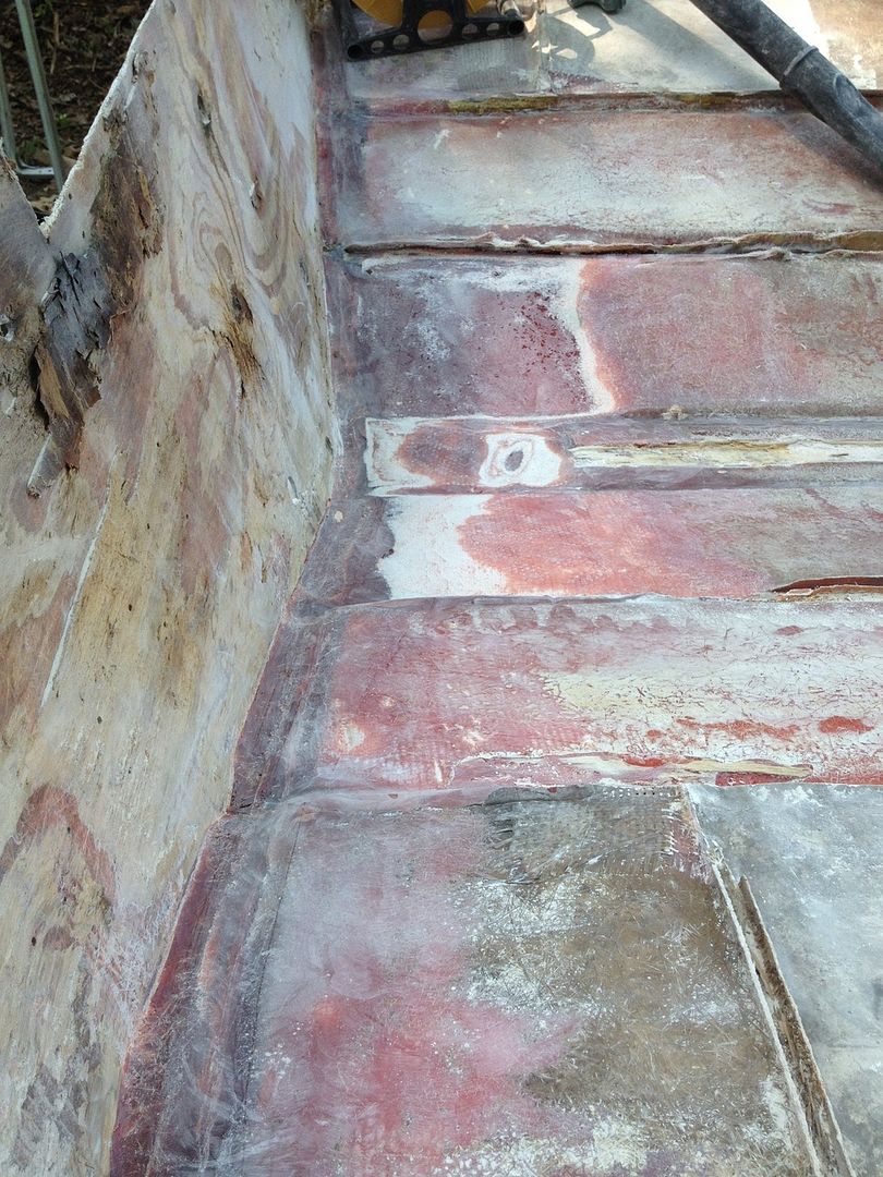

Another view from the side
