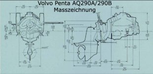

Now I need to place the outdrive transom shield. I found some drawings I hope are accurate to work with and make my cuts from. And I can't go off the old 280 holes on the outside cause they ain't there no more. Fingers crossed I don't screw up oh the pressure.

The drawings for the outdrive(s)

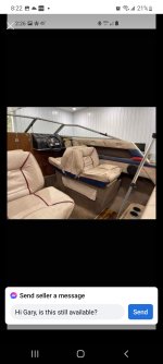

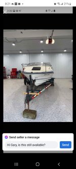

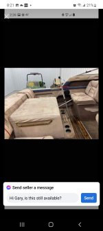

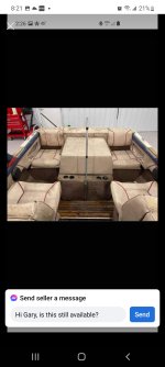

Ha Ha I came across my boats sister with the 4cyl volvo instead of the v8. It even has a similar trailer except for the extra axle on mine which I imagine is for the added weight of my v8. The guy was ready to give up cause he couldn't get it to run..

Placing the outdrive is the hard job for this week. I really only get one chance at this one. The boat that the 290 came out of had the cavitation plate about 1" above the bottom of the boat according to the drawings I posted earlier. The kicker is I'm not entirely sure where the 280 was located now because we glassed and gelcoated the holes up to gain a good sealing surface. According to the previous owner this boat would touch 50mph. In a little baffled how the 290 was so high and didn't blow out in turns at higher speeds. The Bayliner has a much steaper V at the transom than the Imperial had. I'm trying to figure out how that will affect the placement of the drive height.

The height of the hole is not an issue, its where the ventilation plate is on the drive when installed.
Don't know if you can but I try to find a jig to use/borrow to cut the hole

The cavitation plate height in reference to the bottom of the boat is what I'm trying to get right since there's not much going back once the hole is cut. Though there is a 1" spacer that can be added to lower it should I be to high. I guess Mercruiser's guide can help with the figuring process a little. I really wish I would've made those measurements before.

you already have the hole so your X-dimension is already set. at most you can only adjust the bolts up/down about 1/4"

Currently I don't have a hole other than what was left open from the 280 and there's plenty of room to go up or down here at this point. Within reasonable distance up or down.
I've had to adjust outboards to get the best run position, but that's a whole other subject since they are easily moved up or down in most cases. I'm still learning here and just would like to make it pretty to close to correct right from the start.
