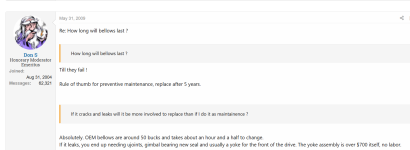

Cheap insurance to replace the u-joint bellows every 5 years or so...per DonS(RIP).

Here's a pic of the Cobra bellows, see if the one for the Volvo has the same ridge. Cobra bellows ridge.jpg
