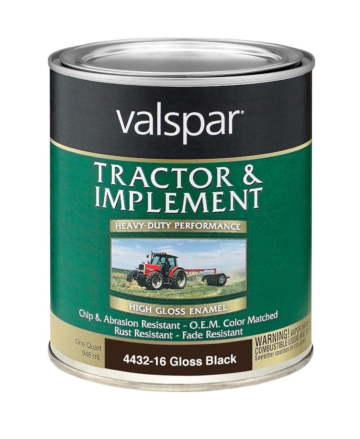

I will likely top coat it with Valspar Tractor and Implement Paint with Enamel Hardener which I am very familiar applying and have excellent results with outdoor equipment. But again, any suggestions?

Top coat paint is Valspar Tractor and Implement paint black:
https://www.amazon.com/Valspar-4432...MY49PJYGJQ67EKEMQ&qid=1560616929&s=automotive
With this as hardener (not sold in California, must buy on the web):
https://www.amazon.com/Valspar-4625...2VTZVF1996PJ3JD36&qid=1560616966&s=automotive
You are supposed to use VM&P Naptha for thinner but it is illegal in California (so I just ordered some on the web) and I used a substitute recommended by the paint store. My guess is that the substitute sucks. I have used Acetone as a thinner before for this paint and it worked fine. I probably should have used it yesterday instead of the recommended substitute.
It is 84 F so it is hardening nicely in full sun.
