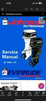

I’m torn between a decision. I’m putting the power head back on but the manual calls for no sealant on the power head adapter gasket. It just seems like failure considering it is just a paper gasket. Most people say to not put any sealant on that gasket. Can any of you give me any insight on what would be the appropriate call?

Do you use sealant on the power head to adapter gasket? My manual says no but I don’t know if I trust not using it

It is a genuine OMC Service Manual? Is the Gasket a genuine OMC/BRP part?

The only thing putting sealant on the gasket will do (apart from sealing ) is make it harder to get off .Im thinking if the book say no sealant then its probly not needed but ......whenever I find myself in this situation , usually rocker covers , that I need to seal well but also come off easily I put sealant ( or gasket cement )on one side of the gasket to stick it to the rocker cover and I put grease on tother side so it comes off easily, stays stuck to the cover and can be re-used many times.

Thank you for that insight. That helps me a lot! I appreciate it!
