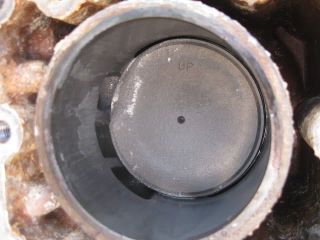

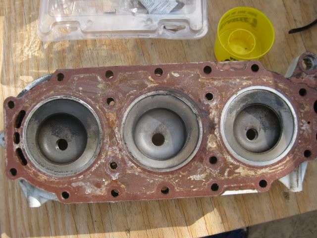

Well its not pretty....
#2 is DONE!!!
It looks at first glance like fuel starvation for that cylinder?? if you look at the bottom of the head at the other 2 cylinders, they seem wet compared to this one... that piston is gone... so is the cylinder wall, and the inlet into the piston chamber... it almost looks melted, one odd thing is the surface is "potted" where the air/fuel comes in... hard to describe but you can kinda see it in the picture.

well I went through the carb again for #2 and I don't see anything wrong... float is good, bowl was full of gas, orifice was clean... boat was running great, no hesitation, nothing...
Anyone know what may have happened?

you can definately see where #2 blew out,

What spark plugs are you using?

possible no tstat, water flows faster than it can disapate the heat, #2 is the center cylinder, and harder to cool.

If the ring gasket in center of the float bowl leaks air it can lean out severely by reducing the vac signal on the main jet.
