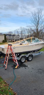

just some 2x4s. Mark them and re-use next year
