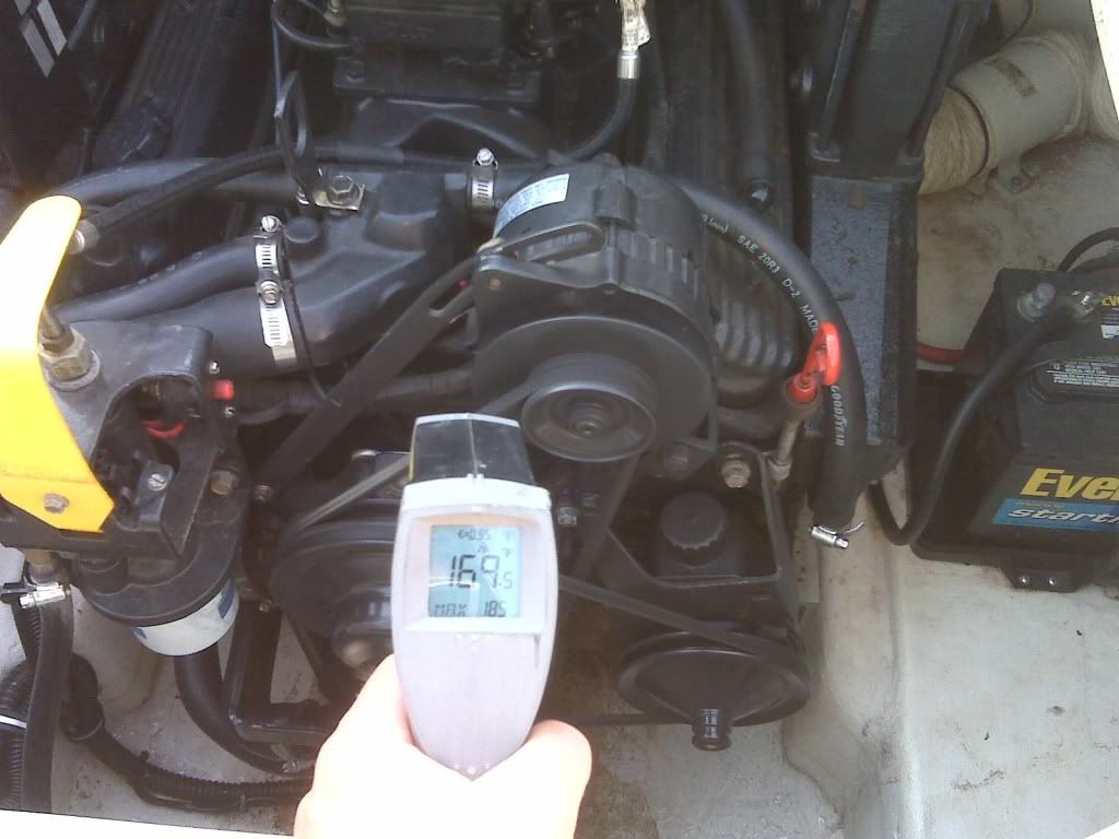

OK 2 hours later i have a lot of data - hopefully this helps
I installed the impeller again and replaced all 4 screws and ensured everything was tight. She started right up and was not leaking anywhere etc, i was off to a good night and if anything else i will never pay anyone to replace my impellar again as it is easy
Let her run at a high idle (2200 rpm) for about 7 minutes and she never got over about 130 on the gauge (this is where my last boat always ran) thought i might be in luck
got out and put her on plane was going straight with the trim all the way down and it stayed right at 175. I thought SWEET but it was not to be. I turned right and it started heating a little right away. got back to straight and it cooled off a bit. I then stayed straight and was back at 175 then i trimmed up / out a little staying straight without turning at all and as soon as i did that it started climbing and went right where it always does to exactly between the 200 and 250 marker and stayed there. It climbs from 175 to this position damn near instantly under both scenarios ( when i turned and when i stayed straight and just trimmed up a little). Also as before if i dropped the hammer and got up to 48 mph and 4400 RPM it came down from 225 to 200 on the gauge
I then spent an hour taking temps with a IR gun. Here is the deal looking at this photo
Looking at it from this angle the right riser is always about 20 degrees higher than the left riser but the right valve cover is always about 20 degrees cooler than the left valve cover. Right riser at max temp on gauge is 170-180 and left riser is 150 - 160
When gauge is reading about 225 the place i have shown in the pic (The base of where all the hose comes together) is right at 200. As soon as i am idling it comes down quick. when the guage is right in the middle at 175 this spot is reading on the gun about 165. If i shoot the engine block just below and to the right i get a similar reading to the spot i am showing in the pic
So at this point i think it is safe to say it is running hot and replacing the missing screw, etc made no difference. So i need help with three things
Why was it fine at 3000 rpm and 30 mph when in a straight line and with the trim all the way down / in. What causes it to go up really fast with either of just a little turn or just a little trim. I have no way short of the marina coming to get it and take it back to their shop to do anything drive related and i am hoping that is not it but it seems to me i must have an issue with sucking water into the boat vs getting water thru the engine
what does it mean that one riser is 20 deg hotter than the other and the opposite valve cover is 20 deg cooler? and at the temps i gave is it ok to use the boat. It run perfect and i just am hoping for this PITA to be over with
Anyway that is all i have. I hope this info is useful in helping to diagnose it. Please let me know your thoughts
Thanks,
Robert

When i read the tstat housing it is never above 160 degrees. It is hot (200-205) right where the housing meets the engine. Am i reading the right place. The housing itself is never over 160 degrees?????????????

Bifflefan - as you can see in the pic I was able to shoot it with an IR gun - isn't that pretty much what you are suggesting. It looks like the gauge is pretty accurate as when it read 225 on the dash i was getting readings of 200-205 on the IR gun

Air bubbles will tell you if its sucking air in somewhere between the water pickup on the lower to the engine.
The fact that when you turn or trim up it gets hot is an indicator that something is going on with the transom hose or drive.
Just a guess at this point.
I always aim the IR gun at the brass base of the water temp sender.

You should be pointing that heat gun to the heavy metal parts of the block in various locations above and below the risers. The differences in riser temps suggest possibly focusing your temp shots on that side but you will need to get below the risers to do temp shots as well.
Before you start climbing around though, I would definitely aim that gun directly at the temp sensor to validate the heat levels there. It could very well be the sensor is bad. If it is, replace it and retest everything. I also like the idea of replacing (even if temporarily) the temp gauge on the dash. It's a very cheap step you can take yourself.

I am the bun right at the bottom plate of the engine where the T-stat housing is and it is very close to the gauge on the dash (it is ready 200-216) when the gauge is between the 200 and 250 markers so i think the gauge is good
While the risers are always 20 degrees apart it seems and the opposite from the riser valve covers are 20 degrees apart the block itself is right about the same all over and it nearly identical to the t stat housing reading. One side of th block is the same as the other
