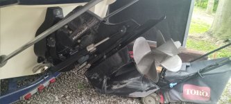

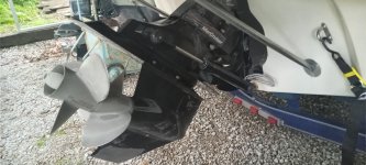

Once it sits down it goes up to 5.5rpm or so. Gains speed. I also noticed on my cylinders for the drive there is a limiter that doesn't alow the drive to drop all the way. Would removing this making the drive drop more help me? Its about a 2" ring that I bolted to the end of one cylinder.

Without a picture, it almost sounds like you're referring to the sacrificial anode on the trim cylinder. I wouldn't remove that.
Any chance you can post a pic of the trim cylinder??

Actually your 100% right. That's what it is..

Some picks of the drive.
52,432
those are anodes to keep corrosion at bay.
