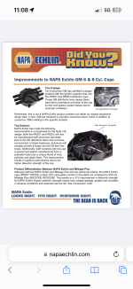

The line of products is called Echlin and they carry a lifetime warranty so the counter people are always very cool about exchanging it. I’ll try to find the article that talks about why Napa developed the special style crab cap to address the issues that plagues the other ones.

The first link points to a distributor cap that has brass. The ones that I am buying look 100% to be aluminum.
