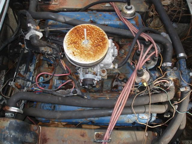

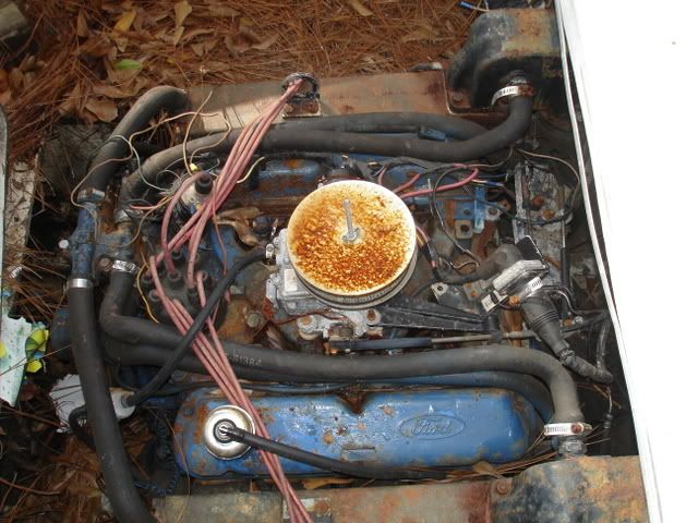

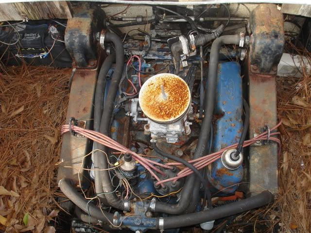

I dont see any numbers on the engine so I can't be sure. I do know that the 351 intakes are wider than the 302 intakes. This intake measured across the intake from center of mounting molt hole, to center of mounting bolt hole on opposit side is 9-1/4 inches. It really looks narrow for a 351.

It's a 351 RP, the 302 is 7 1/4 ctc on the opposing bolts.

Here's the pictures of what I've got,..... I don't know that it's a 351, but was Told so.... I just found Boomer's reply to my PM,+ haven't wandered back out,+ Measured it.....Yet...
It's got Frozen block syndrome,...... I sent the Motor Mounts,+ Flywheel Cover to Dennis Moore about 5 or 6 years ago,..... He Stiffed me for the $40.00 Shipping,+ the Donation to the Shop Fund,.... Haven't heard a word from him Since....... I guess he must be a Liberal Too.....
This thing is going to become a Mooring Block,.... So Whatever you See is available to Any of you Guys who want anything.......
