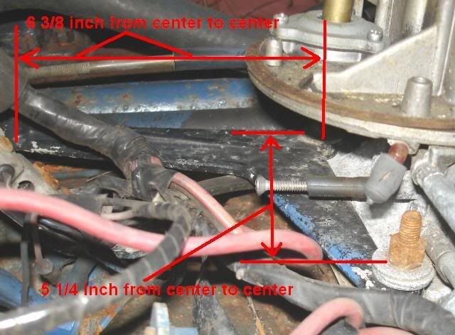

Bond-o, I'll try to develop some dimensional requirements for the bracket and get back to you. Then you can see if it worth an attempt to do anything. Two dimensions I could use from you is the distance between the cable fastening point on the carb bracket and the cable holder out at the back end of the bracket. Then the length of the current bracket from the front mount hole center back to the center of the cable holder.
I can then make a mock up to determine the proper cable bracket length for use with a 4 bbl.
Basically it would require two mods. One is the bracket length, the other would be the ctc width where the bracket would need to mount over the wider rear manifold/carb base studs for the 4 bbl application.
I Think this 1 belongs Here,........
The measurement from the Cable Mounting Pin, to the Carb. Mounting Stud is 7", ctc.....
From the Cable Mounting Pin to the Carb Lever,..?..... You'll have to Wait til tomorrow.......d:)
The Width shouldn't be Too hard,.... If I can find a Squarebore Manifold laying around here, I'll use it to Jig it together......
Or the 1 on That motor, If the spread is Right......
Distance back,+ Offset shouldn't be a Problem either......
RP mentions a few things I know Nothing about,........
I might have to find a Holley to check fitments with.....

Here's a pic of the throttle cable bracket with some dimensions of the bracket.
NOTE: After looking at this engine it really looks like it probably came out of an auto. Notice the vacuum hose bosses and it also has an automotive vacuum advance distributer. :^ There is no spacer between the carb and the intake

Re: `Bondo, Junk 351 Question.....
I bet That's the 1 Boomer Needs,......
It's Different then the 1 I have here........
And on your side note,...... I Agree,.....
I Don't think mine has the Ford logo,+ It's Blue too,....

RP, I might need that bracket......
I will pick up my new engine tomorrow....
The question is:
Do thread highjackers get dibs? :):).....JK
Boomyal
Aug 16, 2003
12,072
Well, RP, yours is the bracket that I could use without difficult mods. The 5.25" is the rear manifold stud width. (2 bbl or 4 bbl) It looks like it would fit under the rear of the overhanging float chamber on a 4 bbl Holley.
But here is the sticky deal. I wouldn't want to try to wiggle my way into middle of Haut, who could use the full meal deal. Or maybe he could use Bond-o's set up complete with it's matching cable bracket.
So give him first whack and if that doesn't pan out maybe I'll get a nice bracket in lieu of fabricating some mickey mouse contraption.
