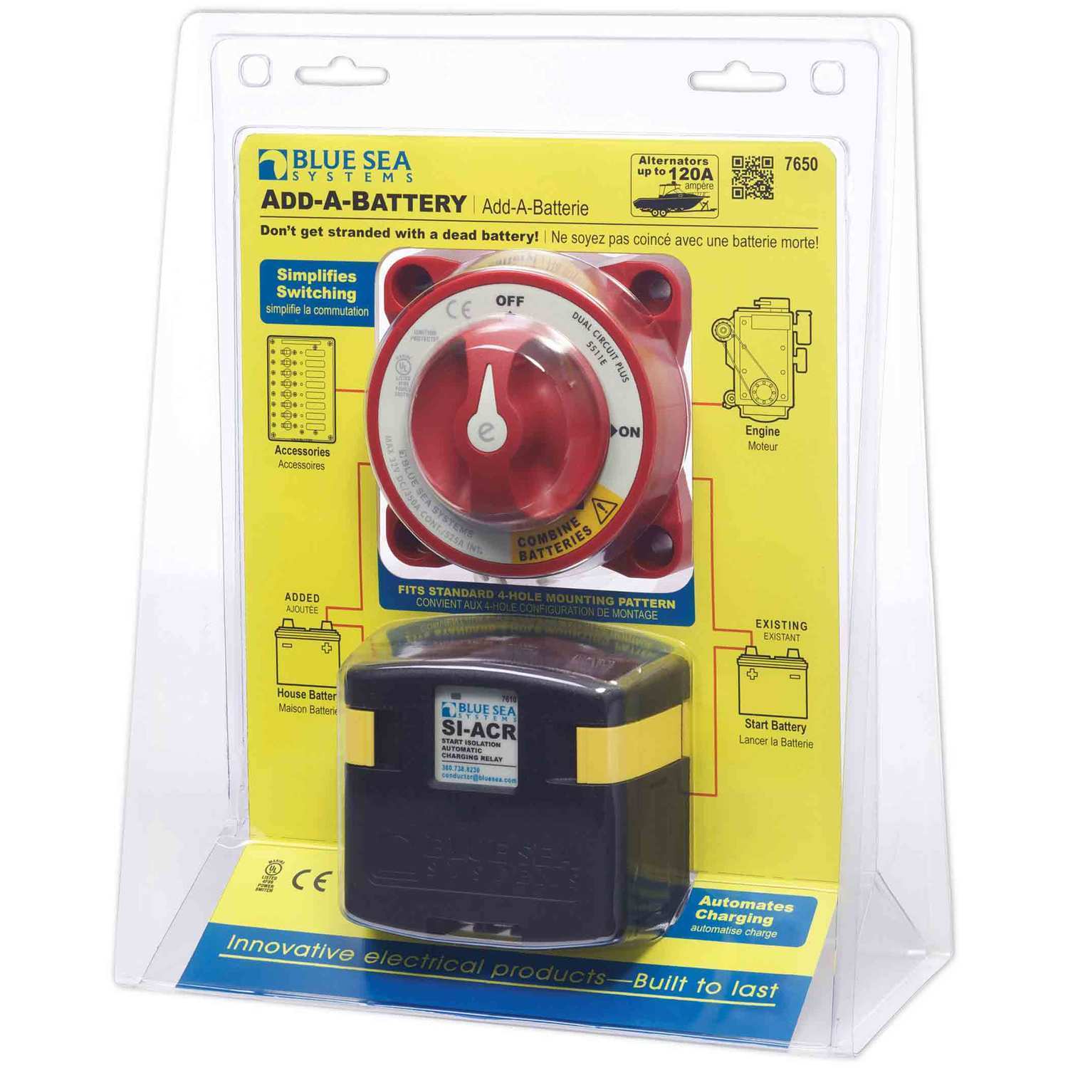

It's beneficial to have a "start" battery and a "house" battery in a boat. The start battery's sole purpose is to power the starter. The house battery powers pretty much everything else - blower, horn, bilge pump, lights, stereo, etc. This way if you take your boat out for a nice day on the lake to drop anchor and listen to tunes, you are only pulling power off the house battery. Your start battery remains untouched and will give you the best chance to get the engine started when you're ready to go back to the dock. There's nothing worse than enjoying the day on the lake, then have a battery too weak to start the engine back up.
If you do a 2-battery system, I also recommend a dual battery switch and an Automatic Charging Relay (ACR). This setup allows your engine's single alternator to charge up the start battery first, then when its full, automatically switch over to topping off the house battery.

Got any suggestions on how to do that?
