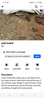

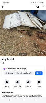

Quick question... just saw a bunch of poly board for sale near me really cheap..... could I buy this instead of plywood and use it to glass in and rebuild the boat? Wouldn't have to worry about rot anymore.... research also hints that it's stronger and lighter than plywood.
Thoughts?

I don't think the glass and resins would stick very well to that. Good buy for something else though! Someone else may have an idea about that stuff for ya though. Gettin the big winds there too today?
