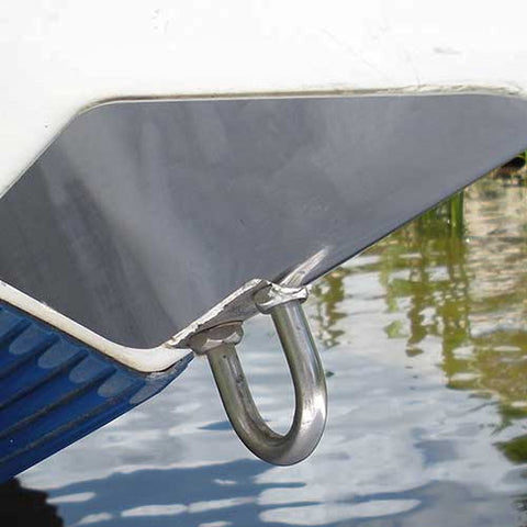

Interesting. I have the rubber roller on mine and it cracked and banged up my bow from hitting the through bolt. I am going to install a poly stop which wont leave black scuffs like the rubber does.
