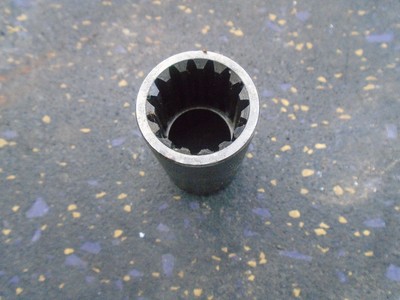

If for sure only the lower gear case housing was removed then maybe the coupling assembly was forgotten that generally rests on top of the drive shaft that meets the upper drive shaft housing...,item number 23, https://www.mercruiserparts.com/bam/subassembly/30977/1943/230
Mercruiser/Bravo Coupling Assembly Oe: 88243A3
Also in order to shift the Bravo drives, it best that the shafts are turning while trying to "Shift" into any gear including carefully turning the props by hand only if the engine is off and the person at the helm shifter isn't going to try starting the engine with the ignition key while the other person tries turning by hand....Have the key in your pocket

Unless the coupler was in the upper unit, there was none on the shaft. And i was kinda surprised that it did not take any alignment of the shaft with the coupler when connecting the lower unit with the upper unit. Or possibly the shaft was misaligned with the coupler, which is pretty much unlikely considering there is not this much space in the upper unit housing and the fact that the lower unit was fully connected and bolted down

9,308
What year is the boat? Drive serial number handy?
It's rarer that coupler stays up in the upper unit but not impossible either or maybe it rolled down the driveway, in the tool bag or used it to open a bottle of beer :D near the refrigerator area?
No shaft to shaft alignment needed when reinstalling with these units.
Are you able to easily turn the prop shaft both ways while having the shifter be put the F_N_R positions?

The prop is not getting locked and spins in every shifter position. As for the loose coupler, that was my first question when i saw the lower unit in a pool of gear lube, if there are any missing parts. The answer was none, but since these two happy campers were already seriously filled with beer, i would not doubt that some parts were in the bucket with gear lube or somewhere under the boat on the driveway. I will ask my friend to look around for the missing coupler. Also i found that there was a torn water hose that i think was from speedometer pickup in the outdrive but i was not able to find any connector on the outdrive where this hose could be going.
