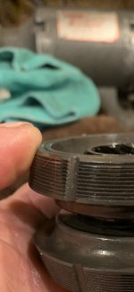

I just got mine tore apart, what do you guys think about the clutch?

alldodge
Mar 8, 2009
43,100
The outside means nothing, it's the inside where the drive shaft rides on the inside of the clutch. What does the drive shaft look like?
