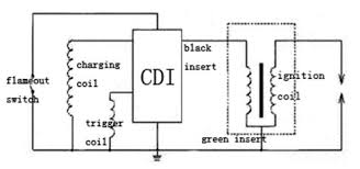

minuteman, yes the primary side of the coil has to have one wire going to ground. Because how else can it transfer the high voltage to a spark plug that is turned/screwed into the engine with one wire to the spark plug tip to fire. So trying to read the primary side will look shorted to ground because of that.
images
As you can see in this schematic, the black wire and the green wire makes up the primary side of the coil. And the high voltage output and the green wire makes up the secondary side of the coil. This is not a schematic diagram of your B&S engine, just a diagram to show why reading the coil can be misleading and look shorted to ground...
