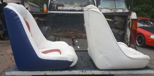

One seat is done. The other should be a snap because the patterns are made, and most of the parts are marked out, if not cut and sewn already.
I reupholstered the seats in my truck five years ago with good success, but I have to say that covering these glorified plastic buckets is more difficult. Overall I am satisfied with how it turned out, and it is pretty comfortable to sit in.
I like the fact that I saved around $500 by not buying new ones. That's substantial to me. Staying in my budget while building an almost-like-new boat.
Staying with the American flag motif, too.

I have yet to strip and clean the second seat, but I went ahead and made all of the upholstery for it. This one waves in the opposite direction.
My original plan for the steering wheel was to wrap the Teleflex wheel that I already had, but at best that would leave me with a nicely wrapped wheel with an ugly black plastic hub and spokes that is too shallow.
I decided that this was a place to go ahead and splurge a bit. Keeping with the American flag theme, I went with white against the blue dash. It is a hard finish, so it should be easy to keep clean.
The adapter hub is polished aluminum. I think it brings out the bling of the gauges. I'm anxious to continue onto the interior panels that will bring the look full circle. But I need to get back to the outdrive and get the boat operational.
