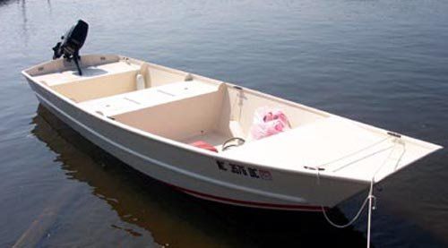

Here is a photo of a finished one. Hopefully mine looks something like this.
This will be my first wood boat from scratch.

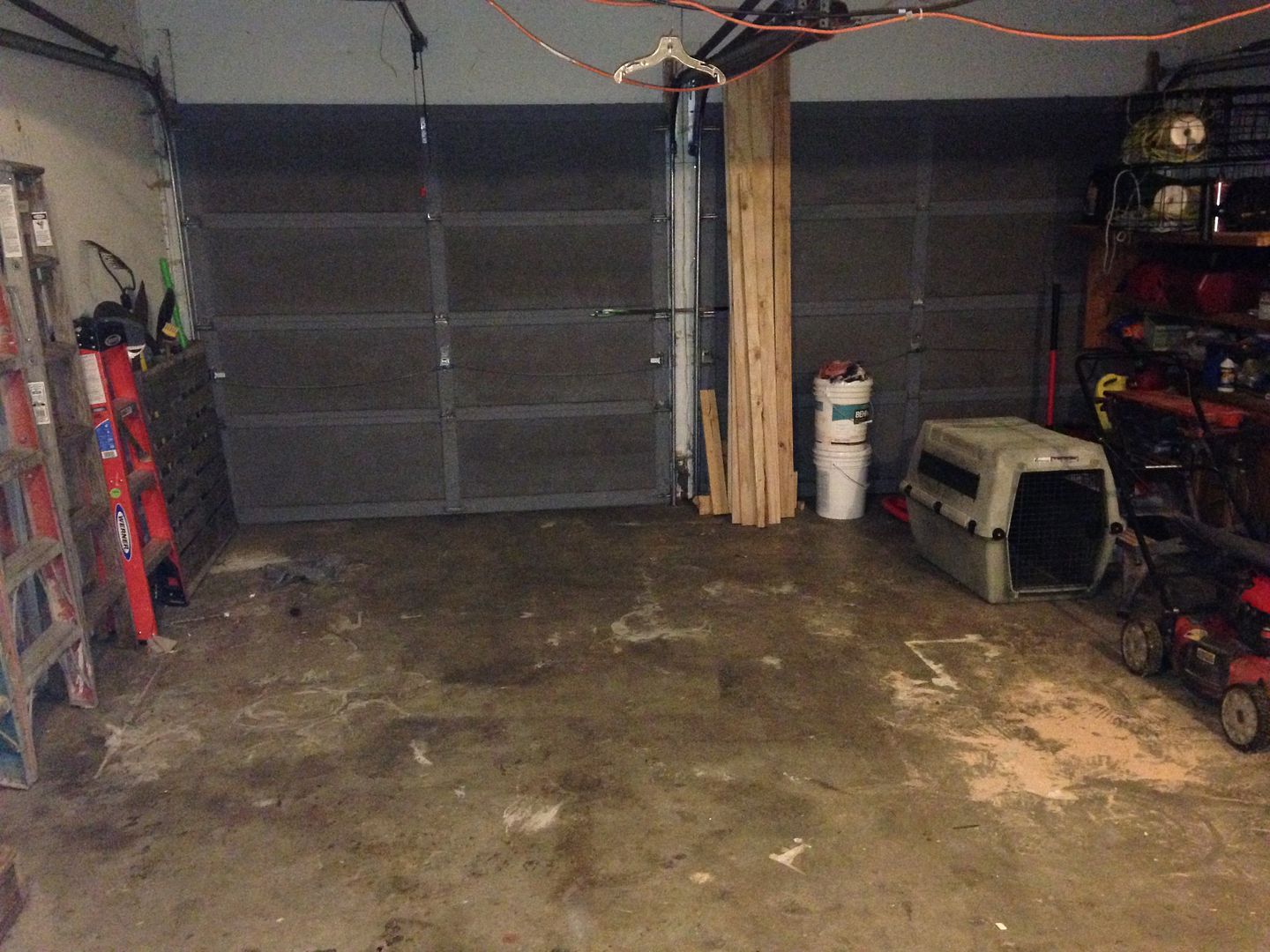

Got the garage cleaned tonight. I am ready to begin. Just waiting on the plans to arrive. Hopefully will see them this week.

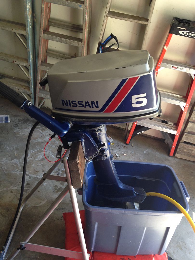

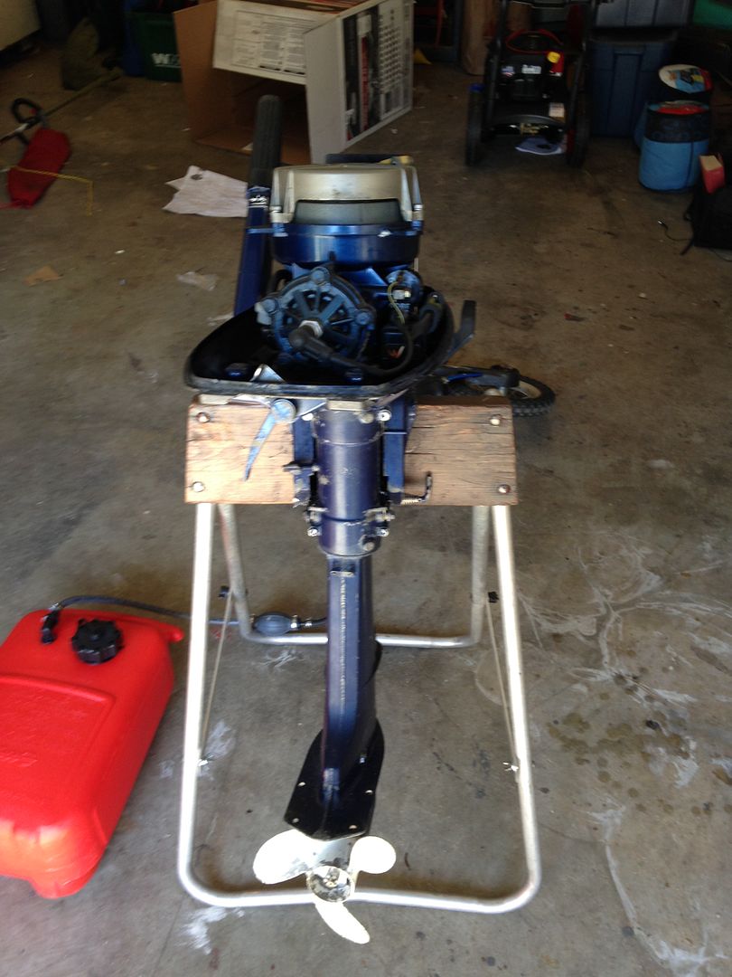

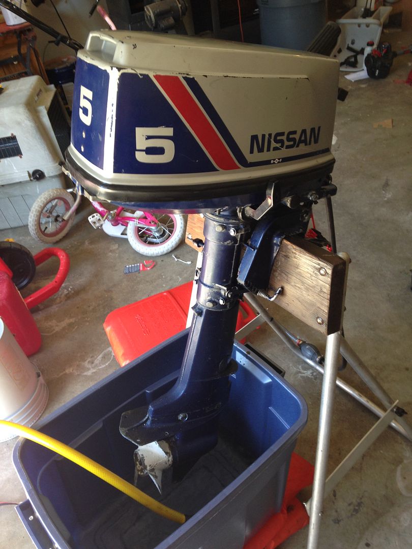

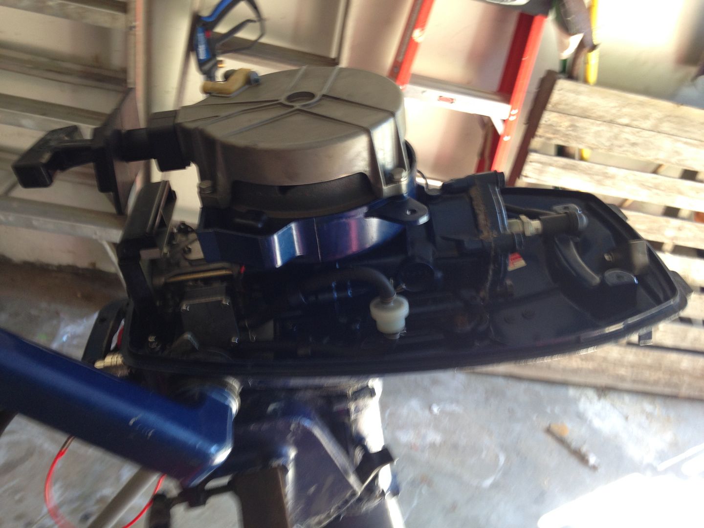

I am a little ahead of myself here. I bought this little nissan 5hp today. $300 for everything. Runs great, has a brand new impeller in it and the motor is very clean. It is a little small for a 16ft, but it will be enough to move up and down the river. It will also make a great trolling motor for my bayliner.

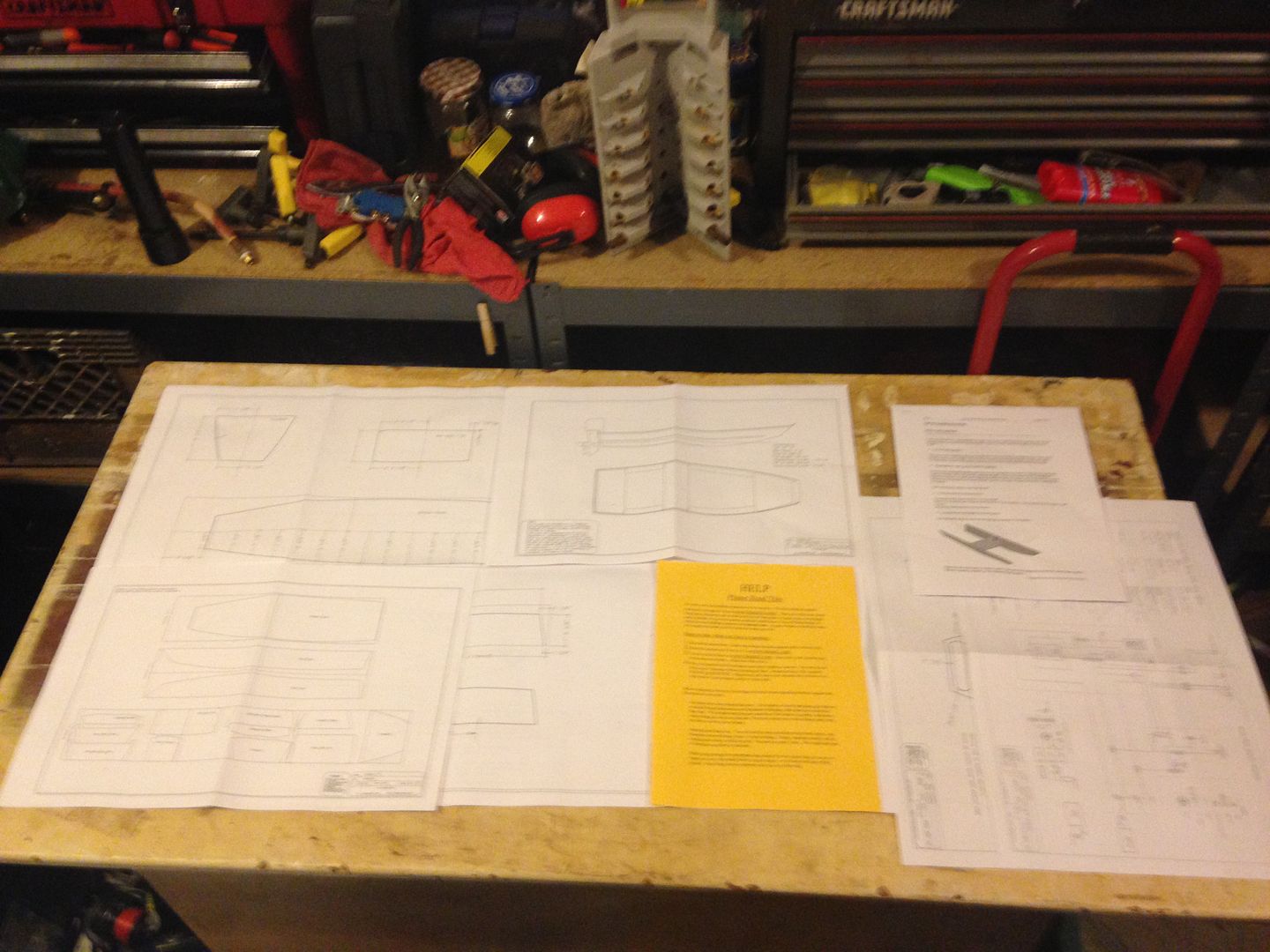

The boat plans are all laid out. They look pretty straight forward. Going to buy plywood this weekend and begin the build.
