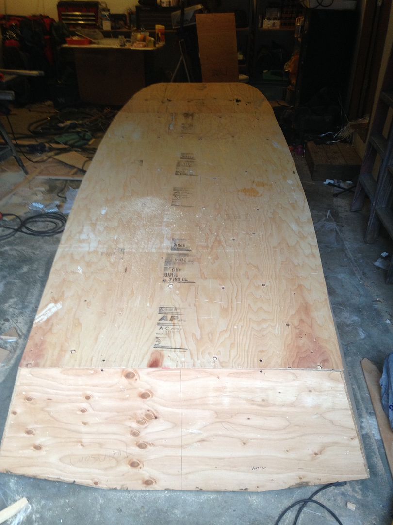

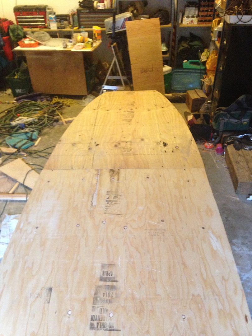

Calling it a night. Got the floor cut out and tacked into place. I will be fiberglassing over this week sometime.

Thanks guys! I have been slammed with work and have no time to work on the boat. I did get half of the bottom glassed last night, but still a long way to go.
