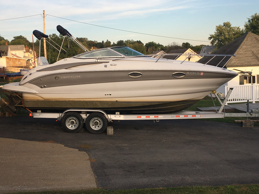

So this summer I moved my winch post and bunks forward about 10-12" cause I knew the tongue weight was light. So pulled the boat Friday and today took it to the scales. Truck is a 2018 2500 Ram 6.4 Hemi outdoorsman off-road package crew cab 4x4. Truck with me in it and 1/2 tank of fuel was 7240. Boat is a 2006 Crownline 250CR with A/C. Dry weight is listed at 6600lbs. Trailer is a 2016 Venture aluminum tandem axle weighing 1325lbs (according to Venture). So boat had about 20 gallons of fuel in it, 7-10 gallons of fresh water and black water was empty. Everything else was as we use it with anchor, life jackets, etc. Total weight was 15,900lbs. Truck with trailer connected but only weighing truck axles was 7920 so 680lbs tongue weight. Works out to 7.9% tongue weight. If I had a full tank of fuel that would add 300lbs and maybe 100 extra on the tongue. That would put tongue weight at about 9%.
So boat itself was 7335 (dry weight listed as 6600).
Here are before and after pics. The before was with the boat back about 12" further. The after was after I moved the winch post and bunk boards and is the way it sat today on the scales.
Forgot to add, I'm looking at buying a different insert rated at 15,000lbs and my trailer sits slightly higher in the front so if I get a little more drop that will add a little tongue weight too.
with truck (before also):
AFTER:
