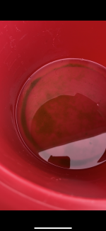

Wow there is a lot more replies here than I expected, thanks for the help everyone!
I haven’t had much time to be around the boat, working full time and family came in this afternoon, but I managed to buy some tools for compression and fuel test as well as look a couple things over.
I took a short video of what the boat was doing before work, and took a couple pictures of the carb which I’ll try to attach, or make a link tonight. I also heard a pop that I’ve never heard before, I hope you can hear it in the video.
After work (boat was sitting for 10~ hours) I pulled the fuel filter off and when I did, I heard a slight hissing sound like there was negative pressure in the fuel filter (not sure if this is normal). When I dumped the filter out into a bucket, I saw what I thought was sand or rust, but once I put gloves on and touched it, I’m pretty sure it was algae. The fuel filter had a good coating on the inside as well.
Pretty positive this is my issue but I could really use some suggestions on how to prevent this in the future and how to get this out of my gas tank.
Sorry I’m probably adding unnecessary details but I have almost zero marine mechanic experience and an amateur level knowledge on general mechanics, so I figure the more info I can give, the more info I can get.
P.S. is there a special tool to turn the mixture screws?
Also I will have to link the video in a separate reply

Ya gotta get that crap out of your fuel tank and clean the fuel system and carb. There must be a layer of water in the bottom of the tank to get algae in there

I was thinking the same thing when I first saw it, but it’s an aluminum tank and when I touched it, it was slimey and soft.
Might be time to flush the tank. Remove all fuel, remove sending unit. I’ve flushed with water. I took a copper pipe and sealed one end,drilled holes along the end and rigged it to a garden hose, stick it in there and bend it to get past any baffles and work it around. Remove all water you can. I put a couple bottles of iso propel in and about a gallon of clean fuel. Get that mess out also. Then put in about 5 gallons, with iso in it, drive around a bit. Remove that fuel and put in good fuel, one more bottle of iso and run it. Worked well for me. If the tank is easily removable, you can just swish it aroun easier out side. Less hassle, less monkeying around.

I was at the boat today and opened up the tank and it didn't look too bad. Unfortunately my fuel pickup tube is welded to the tank so I can't pull it out to inspect it, nor reach my hand in the tank to feel for the screen. Since I had already pulled the carb off a couple days ago, I put the fuel line running to the carb in a bucket and turned the motor over.
a bit of algae and fuel came out, but it couldn't have been more than a 1/4 cup which seemed low considering I was turning it over for 30 seconds or so.
I turned the motor over a couple more times, but only a couple drips came out after that first crank.
So I am thinking I've either got a clogged fuel line, or my fuel pump is going bad/clogged. Any advice on how to diagnose a bad mechanical fuel pump and maybe how to clear both hard fuel lines and rubber lines?
For the fuel pickup tube, I'm planning on draining most of the tank, then using compressed air to blow any clog or crud INTO the tank, and remove the rest of the gas/crud.
