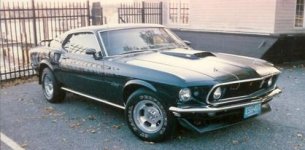

i was only 9 in 69 if i had know Id would have loved to buy one then lol to think you could have done that and if keep them till now I got my 69 fast back in 78
