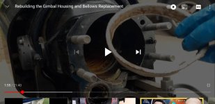

Should I maintain the upper shift shaft lever and shift shaft? I watched a lot of video. But not body mention the red line marked area. But I did see some seal on it. Thank you
