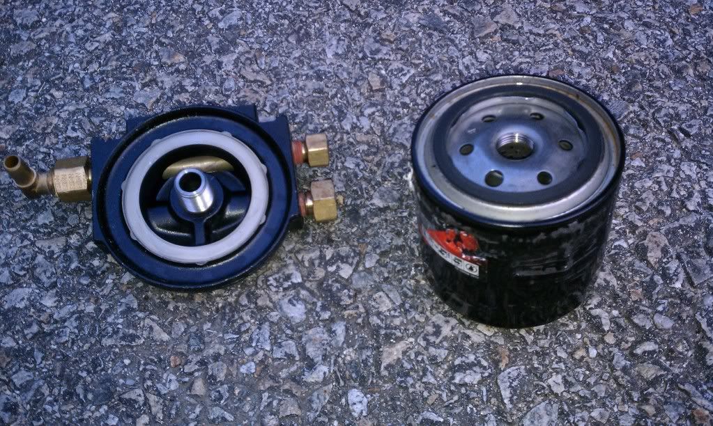

So I removed the main fuel line from the feed side and plugged it with a 3/8ths inch bolt. I then removed the output and return lines from the filter bracket. After removing the bracket completely from the boat I was able to finally remove the filter. I tell you what, that was on there so well there was NO way I would have been able to remove it while still on the boat.
As you can see from the picture, it was the stock filter, and I can guarantee I was turning it the right way from the beginning. You can see the chew marks from the vice-grip style toothed wrench that ended up being successful.
New filter went on with a coating of oil on the rubber seal. So next time it won't be so hard!

Looks like somebody at the factory was a little too enthusiastic putting on your filter :)
