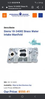

For some reason it came from the factory with a 2 barrel mounted on a 4 barrel intake with and adapter plate.
Look exactly like this one except mine has volvo penta cast into it

Volvo penta used a 4 bbl intake with and adapter to neck down to a 2 bbl.
