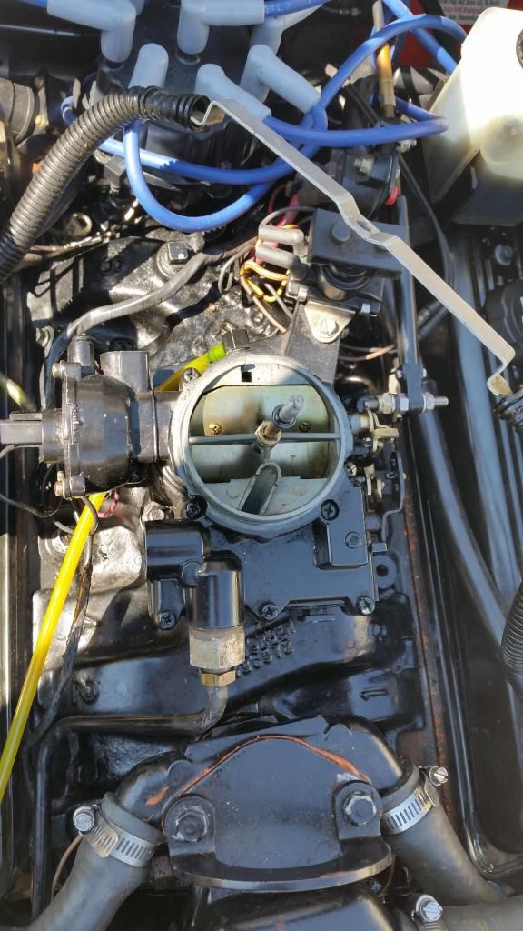

wow I can not believe the responses! Thank you! I Do not have the numbers off the carb yet but will post them when I do. I purchased the boat thinking I was getting a great deal. Long story short I got a lemon. guy put gear oil in the crank so when we tested it for about 30 mins it ran like a champ. took it out for a few hours and lower end was gone. I got a 350 from michigan motorz. (replacing the 305 5.0L). I got it all back together and fired her up set timing and during the break in I could not get it to 3000 rpm's. it starts backfiring through the carb. If i come off the throttle a bit she smooths right out. This is in neutral. I put it under load it falls on its face and backfires up through the carb bad. I have pulled the plugs and they looked white from burning lean. I have put new filters on it, and before the old 305 let loose she ran great, ever since going to the bigger engine I have had nothing but issues, even though its the same block.
http://i180.photobucket.com/albums/x122/trainwrecker22/Mobile Uploads/20140816_115427.jpg
http://i180.photobucket.com/albums/x122/trainwrecker22/Mobile Uploads/20140816_1154440.jpg
these are links to pics of the carb

You might be having trouble with the 305 carburetor being unable to feed the 350 at higher engine speeds. The Mercarbs have replaceable venturi clusters I believe. They do what jets do on other carbs.
But also you could very easily have a fuel supply issue. Sounds like it's a lean pop. Since the boat is unknown pull all (I'd expect 2) fuel filters and dump the big one in a glass jar to check for debris and water. Remove the anti siphon valve at the tank outlet and poke a plastic stick in the tank end to make sure the little restrictor ball moves against it's spring. And spray it out good with carb cleaner. While the fuel line is off the tank take it off the pump and shoot some carb cleaner and air through the line too.
You can replace or repair the carb, sure. But I'd be darn sure it's getting enough fuel.

Your running way to lean. The pics look like a Merc 2brl carb and as NHGuy mentioned it could be re-jetted but the 4drl sounds like a better option. Don't keep running it lean, your spitting pieces of your engine out the exhaust

What you are describing in post #5 sounds to me like you have a couple plug wires crossed up.......... I would double check and be sure, That mercarb should work fine well past the 3k mark. IF it runs lean it would be at the top of the rpm range...........unless the carb is screwed
