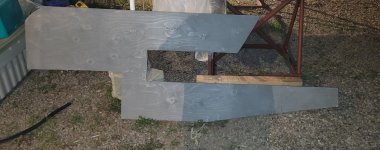

An old picture of the interior of my boat. I want to make side panels of fibreglass. I picked up some 5/32 thick Meranti plywood. Would 2 layers of 1.5oz chop strand mat with 17oz 0-90 glass in the middle be strong, light enough. I will make arm rests made of vinyl and foam for comfort. This is my template.
