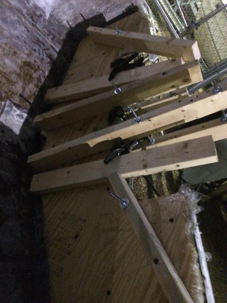

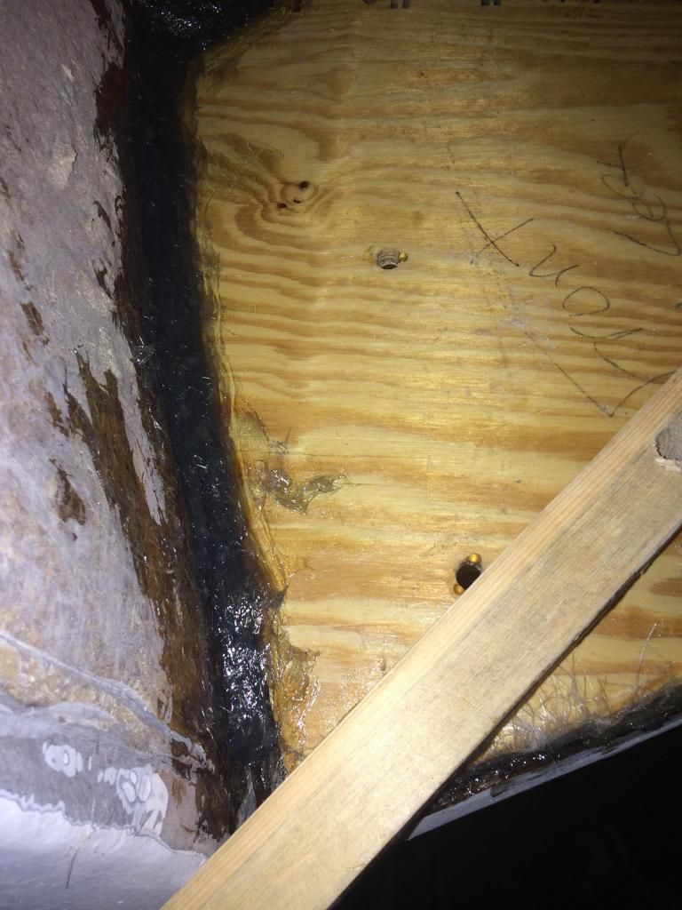

Ok I was able to get the transom installed today. It didn't go as I had planned but I think it worked out ok. I couldn't get the clamps to work as I would have liked so I went to plan b before I started. My first batch of PB was way to thick and the second very runny but combined it seemed to work good. My last batch of PB ( of course smaller) was great. I think it will be very strong plus there is sheet of diamond plate that was there before.

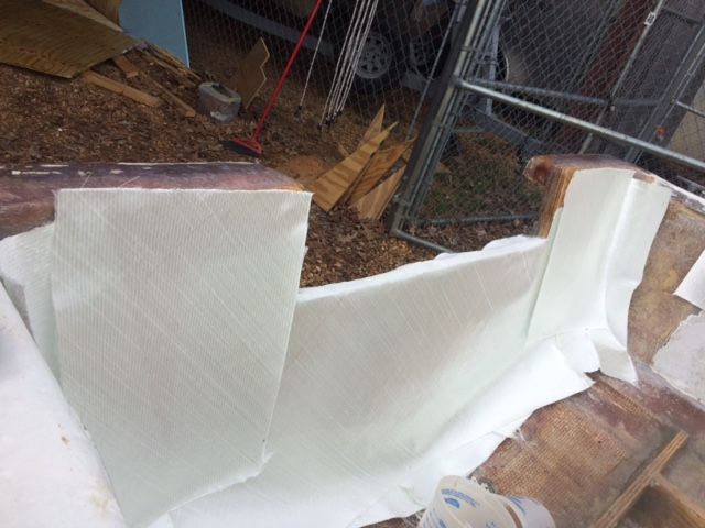

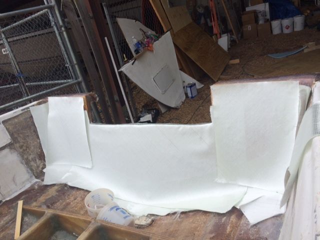

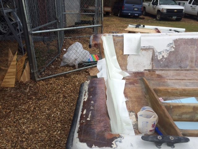

Well I have been able to get some more work done. I am tabbing the transom and have some questions.
I wasn't ablevto get a full price of 1708 to cover the transom. I centered my price and priced in the sides. How do I need to do the second layer?
I am also going to glass it over the side of the boat.

I'd recommend starting at the edges first, and working towards the center. Same way on the second just extend the tabbings on the edges out about 3" -6" further than the first.

I will do that and I also have my corner and bottom tabbing under the large portions of 1708.
