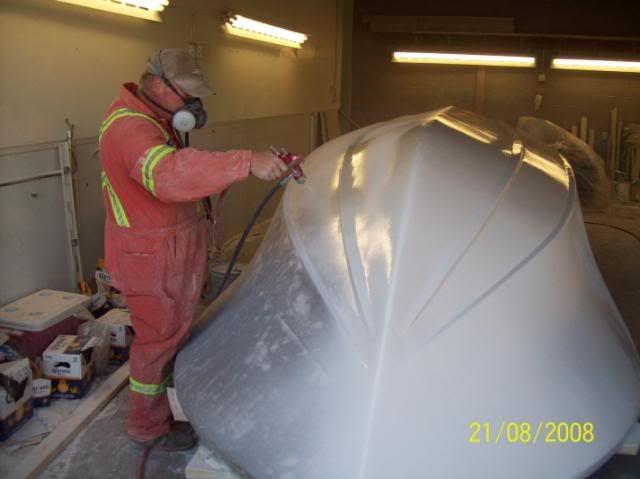

this boat was shot at 55 thou all at once
the boat was walked around three times....this is still the first pass
second pass
and after the third
it took us three hours to shoot this......each pass at one hour......
