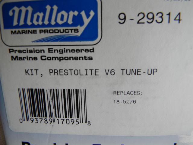

I am going to do a complete tune up tomorrow was looking at the condenser that came in the kit it has a copper strip instead of a coated wire never use one like this, plus came with a sleeve I think should go over the copper strip. Kit is for a 86 4.3 prestolite set up Thanks for any help.

Just cover it with the sleeve.
I believe it's cheaper to make them this way.
I never liked it. Keep the older one, (just in case)

jerry, Thanks will do just looked kinda funny to me. Will update after tune up Thanks....
