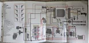

I have a 5.0OSi-E motor in my Regal. My understanding is that this motor is identical to the 5.0GXi-E with the only difference being that the OSi uses the XDP outdrive while the GXi uses the SX outdrive. Therefore, everything should be the same for mine as a 5.0GXi. Although a google search says that the OSi uses TBI while the GXi uses PFI, I can find no data to back that up. I think they both used TBI in the first (A) version of the motor(s), but after that, they both use PFI. Can anyone confirm or refute that conclusion?
Now for the "fun" part. I have been fighting low power issues for a while. Last year, it developed a knock. Hard to tell if pre-ignition or something in the bottom end. The knock sensor (that I knew about...more on that later) tested bad, so I replaced it but it did not change. I finally concluded bottom end and a second opinion from a local marine mechanic also thought the same based on the sound. Finally getting around to rebuilding the motor. Here's where it gets strange. According to the Seloc manual I have (diagram posted below that is supposed to cover C, D, & E versions), there is only one knock sensor. Per Volvo's website, I have the correct EFI manual for this motor...even though it only covers 5.0OSi-A through D, and the wiring diagram also includes only one knock sensor (color diagram posted below too). When I got the motor out a few days ago, I noticed that there was another knock sensor on the starboard side of the motor. I had seen the port knock sensor and knew it was there and when the manual said there was only one, I assumed there was just the one I knew about, but that is apparently not the case.
Does anyone have a wiring diagram for this motor? The ones I have seem to be wrong. All the colors and every other sensor seem to match what the diagrams have, but now I am questioning the accuracy of the diagram. It looked like the wires going to both of the sensors were the same color (black and green) which seems a little odd itself. Now I am wondering if it may have actually been a faulty knock sensor and I just replaced one and not both. I am not sure how they are wired...I assume not in series...but hard to know without a valid wiring diagram. Did I wind up with some unicorn engine or is there really supposed to be 2 knock sensors and Volvo just didn't bother to update the wiring diagram?
TIA

A knock sensor detects pre-ignition, it doesn't detect a rod knocking. It doesn't really matter if the motor has one or two knock sensors. If motor has two sensors they are daisy chained together

I have a 5.0 GXi-E and there is not a wiring diagram for this MPI (PFI) engine. However, based on a lot of hunting around on this forum, I have come to understand that the schematic for the GXi-C is the same, attached. While I have not tested this wire for wire, I have found it to be correct. I put a note at the top of the diagram fm the person who said it was the same but forgot to record the ‘who’. It shows only one knock sensor.
Thanks. That is identical to the one in my manual. Does your engine have 2 sensors?
