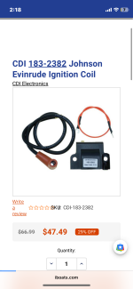

No the evinrude is running on points. I noticed even the right part number is also CDI electronic but for 1969 and some early 70s.
Thanks, i will check the resistance on the coils.

Resistance was almost identical. I noticed on my owners manual it refers to the ignition as C.D ignition . I didnt know evinrude used C.D.I since 1965

If it is in range 500-1000 Ohm then it is for CDI ignition.
Don't confuse a ignition type “capacitor discharge” with an aftermarket manufacturer of ignition components, CDI Electronics
